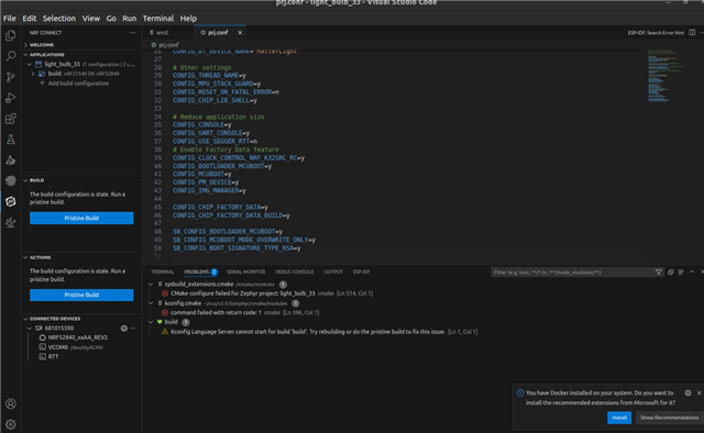

Trouble migrating from NCS 2.7 to 2.9
trying to build matter sample example light_bulb but getting error :
nRF connect sdk v2.9.0 & tool chain v2.9.0 using
board nrf21540dk/nrf52840
following are the building logs

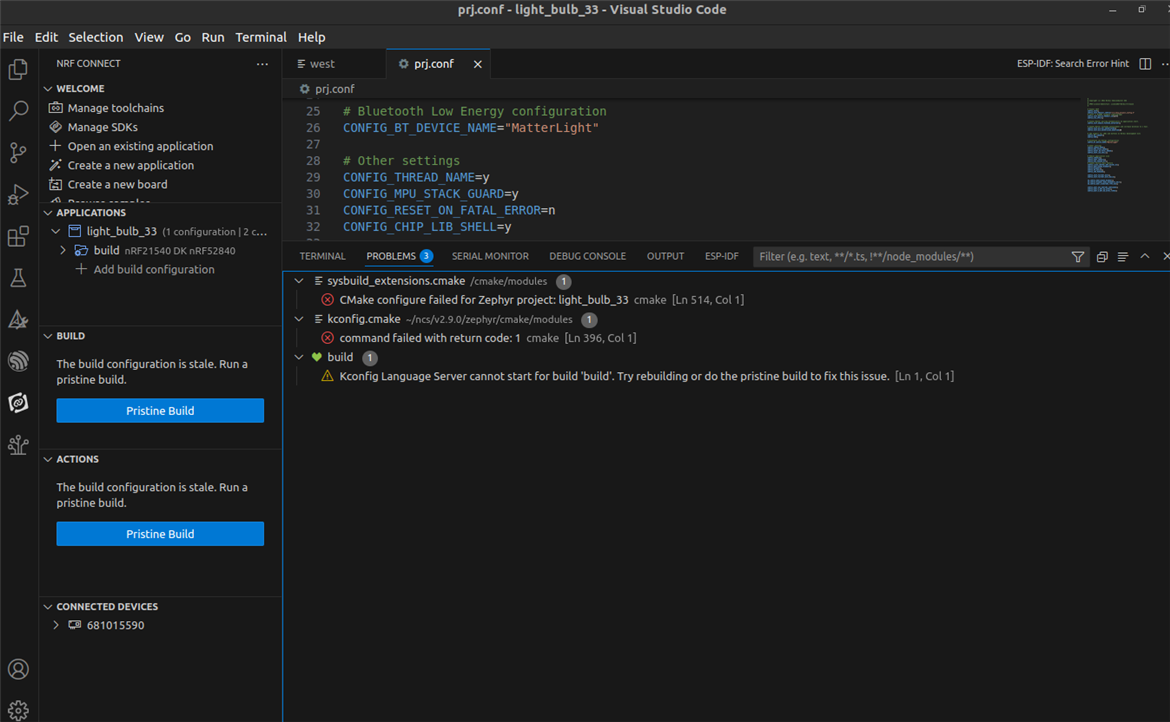

error: MCUBOOT (defined at /home/nistantritech/ncs/v2.9.0/nrf/drivers/hw_cc3xx/Kconfig:10,
modules/Kconfig.mcuboot:8) is assigned in a configuration file, but is not directly user-
configurable (has no prompt). It gets its value indirectly from other symbols. See
http://docs.zephyrproject.org/latest/kconfig.html#CONFIG_MCUBOOT and/or look up MCUBOOT in the
menuconfig/guiconfig interface. The Application Development Primer, Setting Configuration Values,
and Kconfig - Tips and Best Practices sections of the manual might be helpful too.

prj.conf file with error
how i can solve this error so that i can build & flash code successfully ?

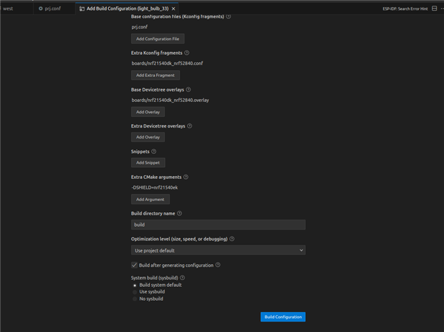

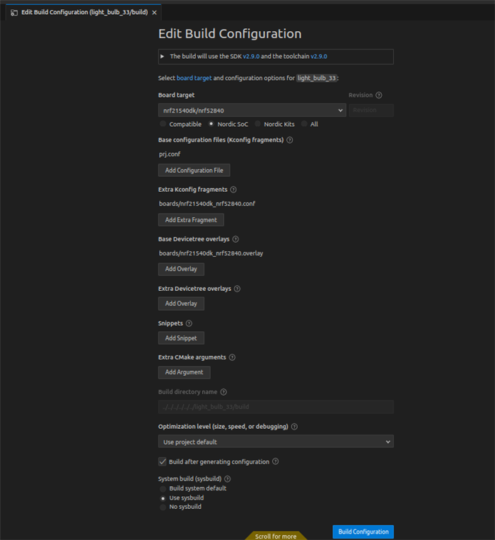

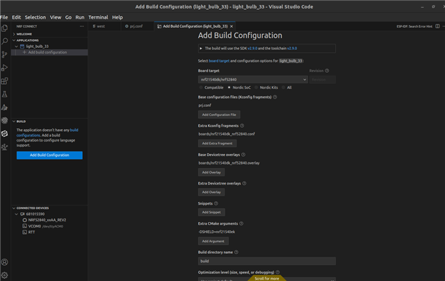

    Are you using the unmodified matter sample example light_bulb? If so, could you try building for nRF52840DK with EK and use Sysbuild?
    Amanda H.
  • i didn't modified anything in matter sample example,
    as you told use sysbuild still error not solve.

  • nRF21540DK does not have the external flash for DFU. Please use sysbuild and build for nRF52840DK with nRF2140EK. See the FEM support section.
