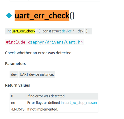

I'm trying to detect a UART_ERROR_BREAK on an USB ACM CDC interface of the nRF5340 using NCS2.7.
static void interrupt_handler(const struct device *dev, void *user_data)
	uint32_t err = uart_err_check(dev);
	LOG_DBG("Error: %x", err);
The returned error code is always 0xffffffa8. How do I clear the error?
