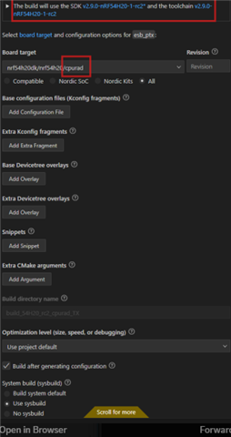

we have nRF54H20DK (rev. 0.9.1), SDK: v2.9.0-nRF54H20-rc2 and the same Toolchain, IDE: VSCode + nRF Connect plugin
build for CPURAD

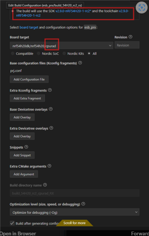

I'm trying to test ESB. The ESB/ptx & ESB/prx sample works fine.
I modified this sample to test the communication throughput. PRX works - build is fine.

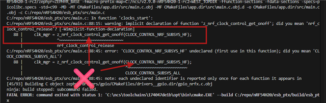

But if I add some clock service to PTX main.c to measure time, it leads to an error in the build phase.

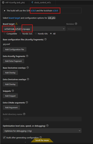

I have the same code on nRF54L15DK with SDK and Toolchain 2.8.0 and it works fine.
In ESB/ptx/main.c there is a problem in "#include <zephyr/drivers/clock_control.h>", but the same #include in nRF54L15 is fine.

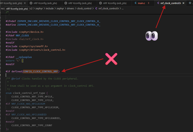

In nRF54H20 I found in nrf_clock_control.h that problem is with constant "CONFIG_CLOCK_CONTROL_NRF".

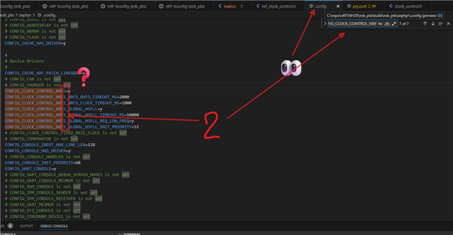

I searched for this constant in .config (in Output) and found a similar but not the same constant "CONFIG_CLOCK_CONTROL_NRF2". I think this is the reason for my problems.
In nRF54H20 and SKD2.9.0-nRF54H20-rc1/rc2 nRF Kconfig GUI interface does not work properly - i.e. when I let ESB find - nothing was found. I did the whole configuration only via prj.conf.
