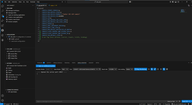

I am using the Ebyte E73-2G4M08S1C module and noticed that it has D+ and D- pins. can we code upload via USB?

This should be possible, but how have you connected your device to the computer for example? And have you built and flashed the USB CDC-ACM sample onto the board? https://docs.nordicsemi.com/bundle/ncs-latest/page/zephyr/samples/subsys/usb/cdc_acm/README.html#usb-cdc-acm
Have you made sure to add board files to match the Ebyte board? We have a lesson on adding custom board support in the DevAcademy nRF Connect SDK course here: https://academy.nordicsemi.com/courses/nrf-connect-sdk-intermediate/lessons/lesson-3-adding-custom-board-support/
