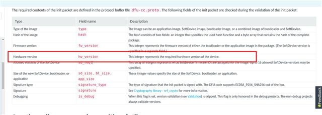

Do you have devices of the same type deployed in the field with different bootloader sizes? In that case, it will be important to ensure that a device with the bigger bootloader does not accept an update request to the smaller bootloader (https://docs.nordicsemi.com/bundle/sdk_nrf5_v17.1.0/page/lib_bootloader_dfu_validation.html) as that could "brick" the device

Yes, you can exchange this via another GATT service. If possible, I would recommend programming a different hw_version, etc to make it impossible to program the wrong version.
