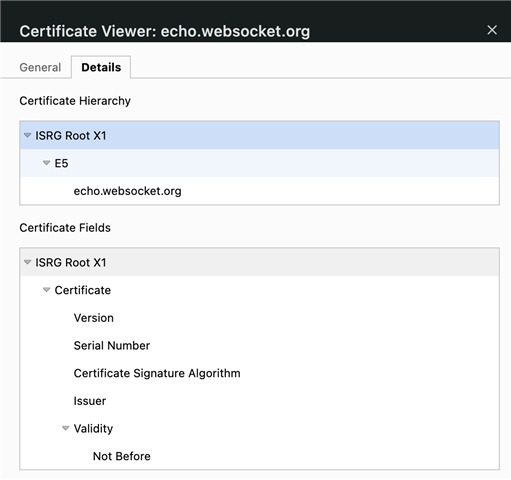

    The website uses Lets Encrypt, which again requires ISRG X1 Root certificate:
    This is downloadable from here:
    https://letsencrypt.org/certificates/

  • We tried both certificates and still got the same error. We are on modem version 1.3.5. We also just ran on modem version 1.3.7. Same error on both modem versions.
    I used https_client sample, added the ISRG x1 root certificate, and connected to echo.websocket.org:
