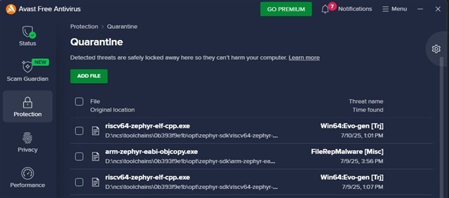

I'm trying to work through exercise 2 of the Nordic Developer Academy. It has me using the Blinky Sample. When I add a build configuration I get an error. I have VS Code 1.97.2, Command Line Tools 10.24.2, J-Link JTAGLoad V8.16, and selected nrf5340dk/nrf5340/cpuapp/ns selected as the board target. I've tried using other sample applications. They result in errors as well when I try to build them.
Am I using the wrong combination of software? The only deviance I noticed during install was SEGGER J-Link wasn't an option during install so I downloaded it outside of exercise 1.

FAILED: bin/tfm_s.elf C:/nordic/l1_e2/build/l1_e2/tfm/bin/tfm_s.elf
cmd.exe /C "cd /D C:\nordic\l1_e2\build\l1_e2\tfm\secure_fw && CMAKE_OBJCOPY-NOTFOUND -O elf32-littlearm C:/nordic/l1_e2/build/l1_e2/tfm/bin/tfm_s.axf C:/nordic/l1_e2/build/l1_e2/tfm/bin/tfm_s.elf"
'CMAKE_OBJCOPY-NOTFOUND' is not recognized as an internal or external command,
operable program or batch file.
