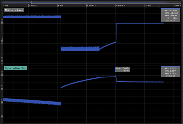

npm1300 IBAT = 0 and ADCIBATMEASSTATUS = 00
With a npm1300 I'm able to charge (for instance, the LED showing charging status is on, BCHGCHARGESTATUS is reporting the different steps..... ) but the battery current reporting is not working properly: IBAT always 0, and  ADCIBATMEASSTATUS is 00 (it should be 01 or 11).
If we measure the real current, it is a few mA, so it is just a matter of the npm1300 ADC or the reporting.
I'm reviewing all the configuration but I don't see anything....
Any idea?
Thanks!!
  • Just to complete the information: the voltage and current are working fine  (see oscilloscope screenshot of IBAT and VBAT for a charging session).
    And this is the configuration that I'm applying  (It is not in zephyr format, but I think it is easy to understand)

    Is the IBAT = 0 both when charging the battery and not?
