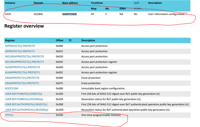

     Im loooking into if it is possbile to store the serial number and other factory specific data in the UICR ->OTP area.
    It has 320 adresses reserved for OTP.
    I will use the nrfutil to set the serial numner
    nrfutil device x-write --address 0x00FFD504 --value 0x0100FF19

  • Hi Tommy,
    I'm aware of the OTP register in the UICR. But the reason that the name changed from CUSTOMER[] to OTP[] is that the OS/drivers will also use some of the registers to store data. We are working on defining where the safe location for custom user data is.

  • Hi Tommy,
    I has reported the request internally. The team is looking at it. But I am not sure if we will have a solution available in your time frame.
    From my point of view, if you decide to use the OTP for the purpose, the biggest risk is when we start using it in the future for other modules in NCS and you need to do DFU update there can be a conflict.
    When you do DFU update to the newer firmware and there will be a chance that the firmware will try to write to the OTP registers that you already written.
    However the chance is quite small, from my point of view, as you only use 4 out of 320 registers. And there still a solution that you can modify the firwmare to avoid using the same area before you do DFU update.
    I would suggest if we don't come up with a office solution,  you can just use the OTP (if using the flash is proven to be too much work). My suggestion is to choose the registers at the bottom of the OTP area.
    This is just my personal suggestion, as the proper way of doing this for now is still using flash. I can't guarantee it will not cause any problem in the future.
