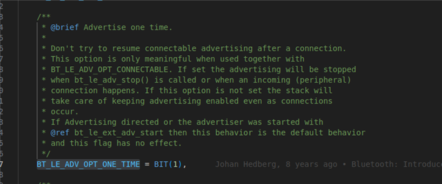

    Does the device start connectable advertising again after the disconnect?  In other words, if you restart scanning in the nRF Connect app after the disconnect, can you still discover your device?
    Vidar
  • no, i cannot discover my device on application.
  • This indicates that the advertiser is not re-started on disconnect. Please also post your implementation of advertising_start().

  • When the connectable advertiser was started with bt_le_adv_start(), the bt host will automatically try to resume advertising on disconnect as you don't have the BT_LE_ADV_OPT_ONE_TIME flag set.
    Removing the call to  advertising_stop(); and advertising_start(); in disconnected() should fix the issue you are seeing with the advetiser not starting after disconnect.
