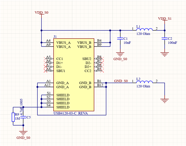

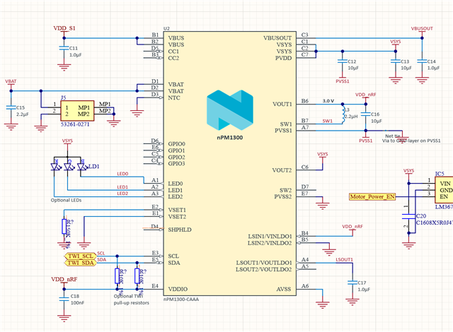

It's not charging at npm1300.
The manufactured circuit did not have cc1 and cc2 of usbc connected to cc1 and cc2 of npm1300.
If cc1 and cc2 are not connected, does it not charge??
Even though cc1,cc2 is not connected, I think it should be charged to 100 mah, but it won't charge. Is there anything else I need to set up in the code?
Power supply through usbc is 5v from the power supply.
