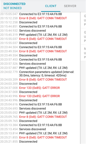

The problem now is that when I try to connect using the nRF Connect app, it immediately disconnects with the error:
Error 133(0x83): GATT ERROR
Can you help me troubleshoot this issue?
    This error is from the nRF Connect app? Did you get any output on the log from the nRF5340 when it disconnects?

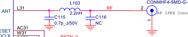

    I am currently using the TE Connectivity AMP Connectors 2108792-2 antenna, connected to the ANT pin of the nRF5340.
    On your custom board, do you have a matching network for the radio?
    Would it be possible for you to share your design?
    I can make the case private first if you prefer it.

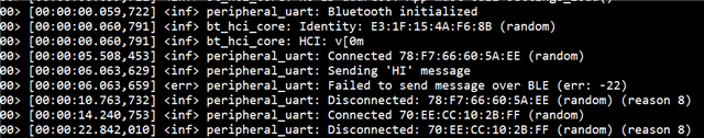

    From additional testing, the connection was successfully established, but it seems to disconnect during the send_ble_message or bt_nus_send process.

    I see from the log from the nRF5340 that it fails to send a message before it disconnects. Can you try to use the debugger and find the function that returns err -22?
    I suspected that it was this line, but the log output isn't quite the same:
    Do you have a nRF5340 DK that you can test with? Can you try connecting that antenna to the SWF port on the DK and see if it works with the development kit?
