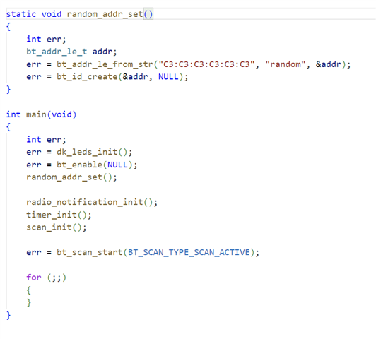

    I found the problem but i don't know why;
    I printk the address of my scanner in "bt_le_ext_adv_cb.scanned" and i find scanner always changes its random address every time i reset the board.Even if i set the random address as follows:
    Do you know why?Could you help me?
    Best wishes
  • Sounds like things are working then.
    From \zephyr\include\zephyr\bluetooth\bluetooth.h you can find:
     * If the application wants to have the stack randomly generate identities
     * and store them in flash for later recovery, the way to do it would be
     * to first initialize the stack (using bt_enable), then call settings_load(),
     * and after that check with bt_id_get() how many identities were recovered.
     * If an insufficient amount of identities were recovered the app may then
     * call bt_id_create() to create new ones.
    I expect the problem here is that you don't have settings_load().
