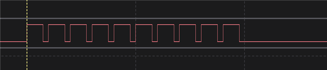

I'm using NRFX PWM directly because I need something more custom than zephyr's PWM driver provides. I'm trying to understand what .pin_polarity field in the config does. It does not seem to invert the polarity of the signal.
All .pin_polarity seems to be doing is setting the pin value after PWM has stopped.
.pin_polarity = {true, true, false, false}
.pin_polarity = {false, false, false, false}

Is the only way to invert polarity by setting MSB of the PWM to 1 (eg: 800 | (1 << 15))?
Also, I'm a little confused why the default "active" state is LOW. Is that expected?
