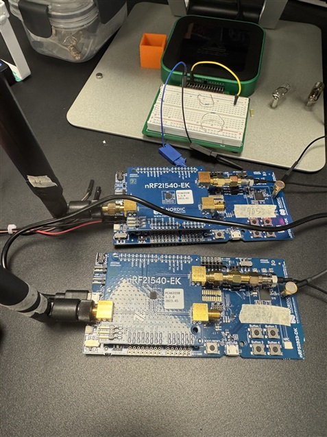

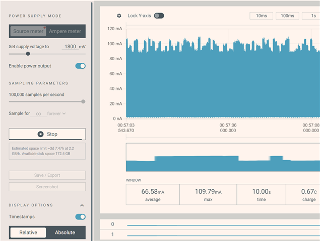

I have two nRF52833 DKs and both of them has connected to nRF21540 EK. I set the transmitter sending out 244 bytes data without stopping and measure it's current. The setup is like below and the average current is around 60 mA at 1.8V

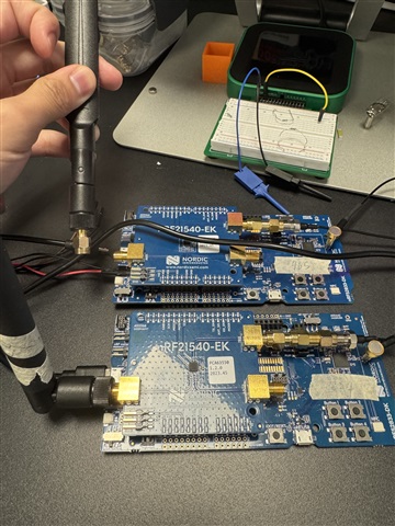

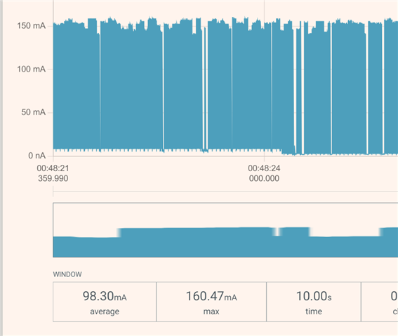

When I plug out the antenna of the transmitter, the currrent reach up to 100mA.
I have no clue about this, as I expect the power has no relationship with antenna. As in both case the FEM is using, only change is RSSI, and RSSI both are at same level. First time is -19, second time is - 24
