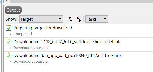

nRF52832 DK UUID error
nRF52832 DK
Keil compiler V5.27
E:\Embed_Develop\Nordic\nRF5_SDK_17.1.0_ddde560\examples\ble_peripheral\ble_app_uart\pca10040\s132\arm5_no_packs

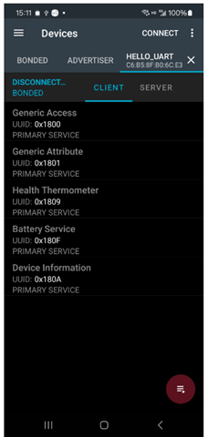

W onServicesDiscovered: Service UUID
E onServicesDiscovered UUID: 00001800-0000-1000-8000-00805f9b34fb
E onServicesDiscovered characteristic UUID:
W onServicesDiscovered: characteristic UUID
E onServicesDiscovered UUID: 00002a00-0000-1000-8000-00805f9b34fb
E onServicesDiscovered Permission: 0
E onServicesDiscovered UUID: 00002a01-0000-1000-8000-00805f9b34fb
E onServicesDiscovered UUID: 00002a04-0000-1000-8000-00805f9b34fb
E onServicesDiscovered UUID: 00002aa6-0000-1000-8000-00805f9b34fb
E onServicesDiscovered UUID: 00001801-0000-1000-8000-00805f9b34fb
E onServicesDiscovered UUID: 00001809-0000-1000-8000-00805f9b34fb
E onServicesDiscovered UUID: 00002a1c-0000-1000-8000-00805f9b34fb
E onServicesDiscovered UUID: 0000180f-0000-1000-8000-00805f9b34fb
E onServicesDiscovered UUID: 00002a19-0000-1000-8000-00805f9b34fb
E onServicesDiscovered UUID: 0000180a-0000-1000-8000-00805f9b34fb
E onServicesDiscovered UUID: 00002a29-0000-1000-8000-00805f9b34fb
E onServicesDiscovered UUID: 00002a24-0000-1000-8000-00805f9b34fb
E onServicesDiscovered UUID: 00002a23-0000-1000-8000-00805f9b34fb
