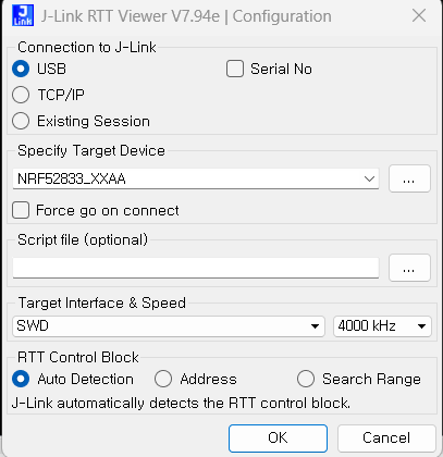

    3. For RTT to work, I attach the two screen shots. (setting and log on our RTT Viewer)
    -setting:
    -log:
    4. Our project is already not a SES project having started on 2021 year.
        So, for the logging from device, we'll use RTT viewer.

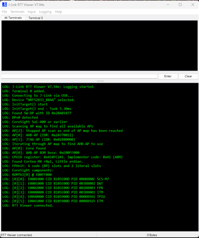

  • I found missing definition,
    NRF_LOG_USES_RTT used in SEGGER_RTT_Syscalls_GCC.c file.
    So I added the definition on our project source.
    However, it dosen't work with RTT Viewer via swd.
    First of all, we can connect  our target through J-link OB debugger RTT viewer.
    The following log says:

    LOG: RTT Viewer connected
    Then, we couldn't see the device logs from our target using RTT viewer.
    I guess the conditions goes good a little, however we can't see the logs.
    Please advice me.

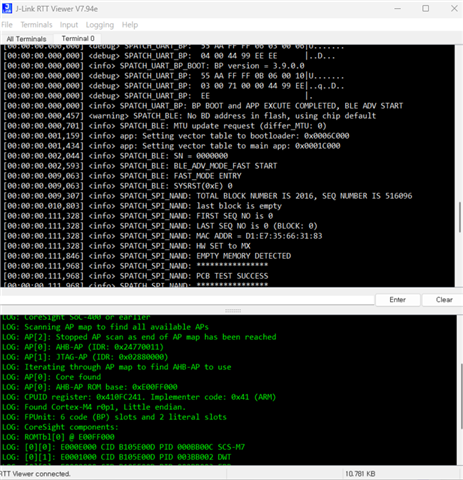

  • I tested ble_app_uart, example on nRF53833 DK when I use on SES and RTT Viewer.
    The example works well on nRF52833 DK as following SES and RTT Viewer's screenshots.
    1. SES
    2. RTT Viewer
    Then on RTT viewer, it works when I pressed reset button on DK board after connecting nRF SoC using J-link OB. I guess it needs to restart the appllication after connecting to nRF SoC on DK board.

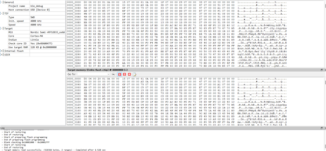

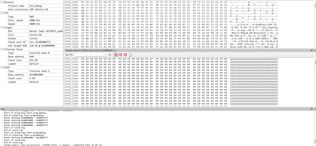

    I found that there didn't happened on RTT device logs on our target.
    When we just download our fw to our custom target via jflash tool, and after reading back on target's memory, it is normal as following screenshot on jflash tool:
    Then the next is when reading back on target's memory ,right after attaching by j-link on RTT Viewer.
    it is abnormal that our target flash memory was initialize and written in 0xFF ,like erasing memory.
    the followings is abnormal screenshot.
    I guess I saw the following logs on RTT Viewer.
    LOG: CTRL-AP indicates that the device is secured.
    For debugger connection the device needs to be unsecured.
    Note: Unsecuring will trigger a mass erase of the internal flash.
    It was erased because of the above message.
    Please check this and inform us why it happened.
    Jaehong Park

    after input command on CLI app, RTT viewer give up device logs as following screenshot:
    Anyway, we started a little more for fixing this issue.
    Then, I guess RTT viewer grabbed and held the booting start of device.
    Please advice us how to fix it.
