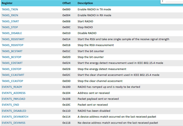

Hi Vidar,
How to read the register value and their offset value like below.
Please give the procedure.
With regards,
Bhagyashree.
Hi Bhagyashree,
It would be easier to provide a proper answer if I knew what you were working with and what you were trying to achieve. Generally it does not make sense to read peripheral task register, and the event registers are typically cleared by the driver in the interrupt handler.
Here is a snippet showing how you can write to and read from the RADIO TXPOWER register. Note that this will not work if you are using the Bluetooth stack.
/* Write to TXPOWER register in RADIO peripheral */ NRF_RADIO->TXPOWER = (RADIO_TXPOWER_TXPOWER_0dBm << RADIO_TXPOWER_TXPOWER_Pos); /* Read back register*/ uint32_t dummy = NRF_RADIO->TXPOWER;
