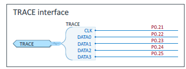

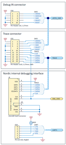

Hello, we've a nRF9161 DK board a we saw on the back side a footprint for mounting an SD card holder and we found the SD card holder component in the BOM.
Unfortunately there is no mention about the usage of the SD card in for the nRF9161 DK anywhere in the documentation.
Is there any problem on using the SD card on nRF9161 DK (trough SPI I guess) ?
What do we have to do to connect the SD card to the nRF9161 module (excluding the soldering of the card holder)?

  • I was talking about J8 on the bottom side of the board listed on the BOM as "microSD Card Connector"...
  • It shouldn't matter whether it is an nRF9161DK or nRF52840DK when it comes to SD card.
    Or did I misunderstand you?

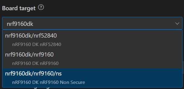

    nrf9160dk_nrf9160.overlay (or the target you're building for as listed:

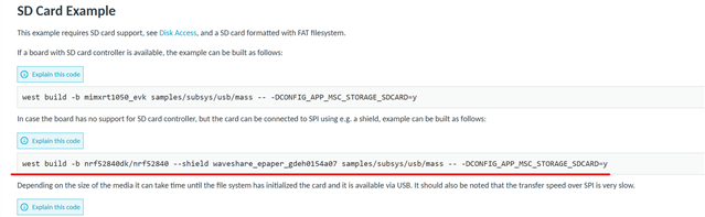

    The next task is to port it to an SD card.
    To do this we need some more modifications (or additional hardware). "west build -b nrf52840dk/nrf52840 --shield waveshare_epaper_gdeh0154a07 samples/subsys/usb/mass -- -DCONFIG_APP_MSC_STORAGE_SDCARD=y" handles the extra hardware since it uses a shield that has an SD card reader, and it adds the extra configuration.
    In addition https://docs.nordicsemi.com/bundle/ncs-latest/page/zephyr/samples/subsys/usb/mass/README.html#sd_card_example takes us to modifications that you need to do yourself, i.e https://docs.nordicsemi.com/bundle/ncs-latest/page/zephyr/services/storage/disk/access.html#disk-access-api and to add a SPI (I assume that this is the peripheral you will be using) that can do SD card https://docs.nordicsemi.com/bundle/ncs-latest/page/zephyr/services/storage/disk/access.html#disk-access-api. An example can be seen in the latter link for how to set this up:
