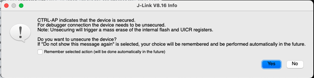

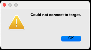

We're experiencing issues with RTT logging on an nRF9151-based project using NCS 2.9.0. When `CONFIG_LOG_DEFAULT_LEVEL` is set to `3`, RTT Viewer fails to connect to the device entirely. If we change the logging level to `4` (debug level), RTT connects successfully, but the logs become excessively verbose, leading to many dropped log messages.

After further experimentation, we discovered that setting `CONFIG_KERNEL_LOG_LEVEL_DBG=y` allowed RTT Viewer to connect even at level 3, but the logs remained extremely verbose and practically unusable. We have also experimented with optimization settings (`DEBUG`, `NO`) without noticeable improvement.
It appears the issue is specifically related to the interplay between log levels and RTT functionality, but we haven't been able to pinpoint the exact cause.
