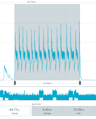

SDK v2.6, Bluetooth scanning : 6.54mA
SDK v2.9, Bluetooth scanning : 11.56mA
What could be the problem?

Hi Leo,
Are you using the same board and sample for these?
Is it a custom board or the nRF52840DK?
Is it your own sample or an nRF application?
Priyanka
Hello Priyanka,
1. Yes.
2. custom board.
3. my own sample.
Leo
Hi Leo,
I am looking into this and will get back to you soon.
-Priyanka
Hi Leo,
Looks like in the latest release the enabling of DCDC has been changed from via KConfig to via Devicetree.
You can take a look at how it's done in the migration guide.
Please try this an let me know if the current consumption goes down.
-Priyanka
Hi Priyanka,
Thank you! This problem is solved.
And the code should be:
