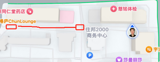

    My estimated distance is about 1,300 meters and using 0 dBm Tx power, I refer to Nordic Bluetooth Long Range is 1,300 meters. The links for reference are as follows:
    https://blog.nordicsemi.com/getconnected/tested-by-nordic-bluetooth-long-range#:~:text=as%20visual%20indicators.-,The%20results,or%20patterns%20we%20can%20identify.
    Is the default Tx power 0 dBm for the periodic_adv_rsp and periodic_sync_rsp examples?
    Please refer to the red box and red line for my test environment, which is about 100 meters away. In addition, I also found that if there are many people or cars passing between two nRF54L15-DK, it will affect the pawr communication. In addition to the modification code you provided, do I need to modify other configurations?
    Thanks.
    Please note that the tests were performed at a remote location, with only two devices involved, with line-of-sight, with little to no interference, over water. In an urban setting, you should expect lower range and more packet loss. 100 m might be at the edge of what is possible, in such a setting. In some instances more can be possible, and in some instances even less.
    Regarding configurations, I am afraid there isn't really much you can do with interference, high noise floor, or other objects blocking line-of-sight or otherwise changing the signal path. Depending on the issue, higher TX power, or to just repeat the transmission, might work.
    For connections, increasing the supervision timeout will allow for more packet loss before the connection is lost.
