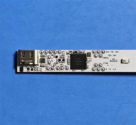

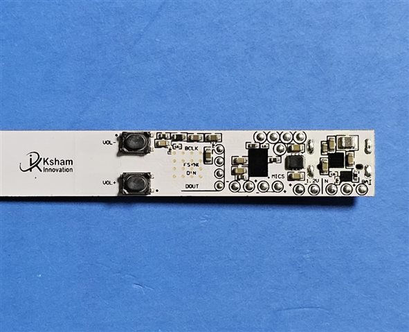

    We are using our custom PCB for testing, the interfaces are quite the same as the nRF5340 Audio DK. (I'm attaching the PCB images below)
    This is everything I have noticed with the audio application as of now:
    (Toolchain v2.9.0, SDK v2.9.0): The entire application code works perfectly fine on the audio dk. But on custom PCB, the HW Codec fails to initialize in the application code, however if I run the hw codec code separately without enabling any other interfaces, it works perfectly fine.
