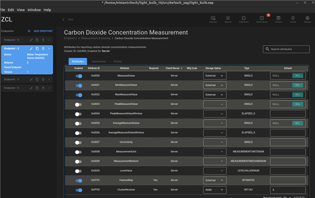

    Maybe cluster revision can be get over chip-tool because it is Storage Option (RAM) - other have external. So, based on your information, there may be some setting issues in steps 3,4,5 of Adding clusters to Matter application.

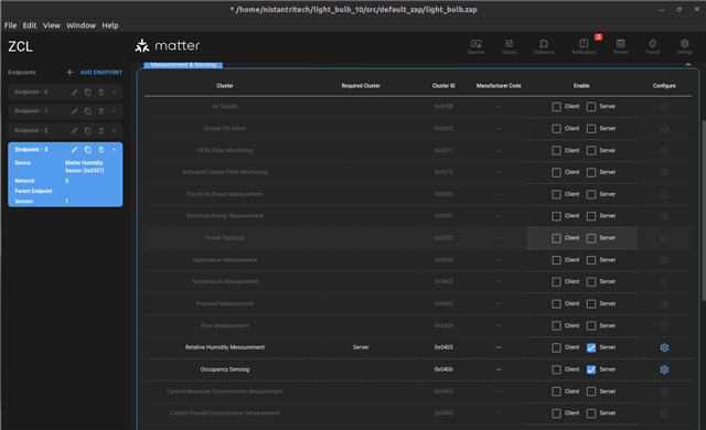

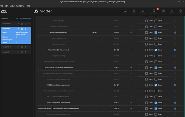

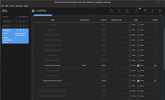

  • - while adding multiple cluster at same endpoint for temperature Required cluster showing server, for humidity & other cluster not showing server
    - when i add multiple cluster on same end point on home pod i'm not getting visibility for respected enable cluster on end point.
    - when on Different End point i add humidity cluster it showing Required cluster As Server,
    for other not showing Required cluster as Server, why ?
    - If i added Multiple Cluster on different End Point then it can shown on Home Pod.

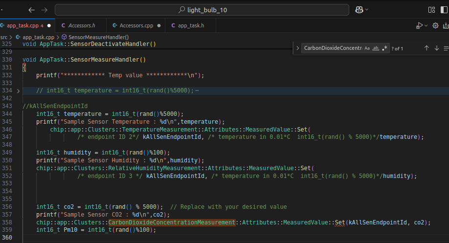

    - one more point i want highlight
    when i'm trying to set Measured-value for Carbon Dioxide it showing Like : namespace "chip::app::Clusters::CarbonDioxideConcentrationMeasurement::Attributes::MeasuredValue" has no member "Set"C/C++(135)  }
    At the time of temperature & humidity Measured-Value successfully set

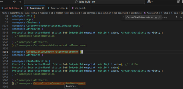

    in Accessors.h there is no function for setting Measured-value, but function for
    Cluster-Revision mention. (same in Accessors.cpp there is no function to set Measured-value)
    Now I want to set Measured-Value (like i'm setting for temperature & humidity, i can read that on home pod & chip-tool) ?
    You need to check the specific device type requirements in the Matter Application Cluster Specification, as different device types have different required clusters.
    Check this post
