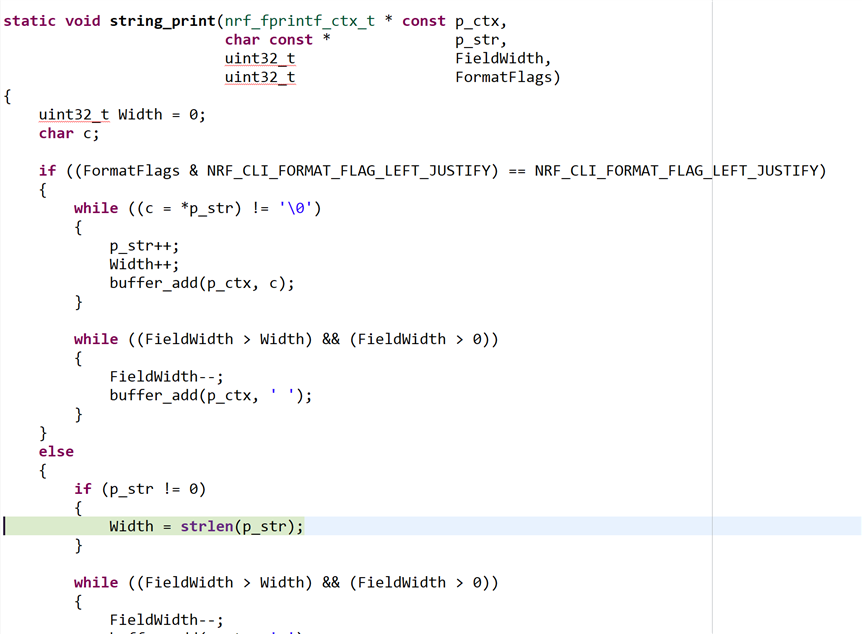

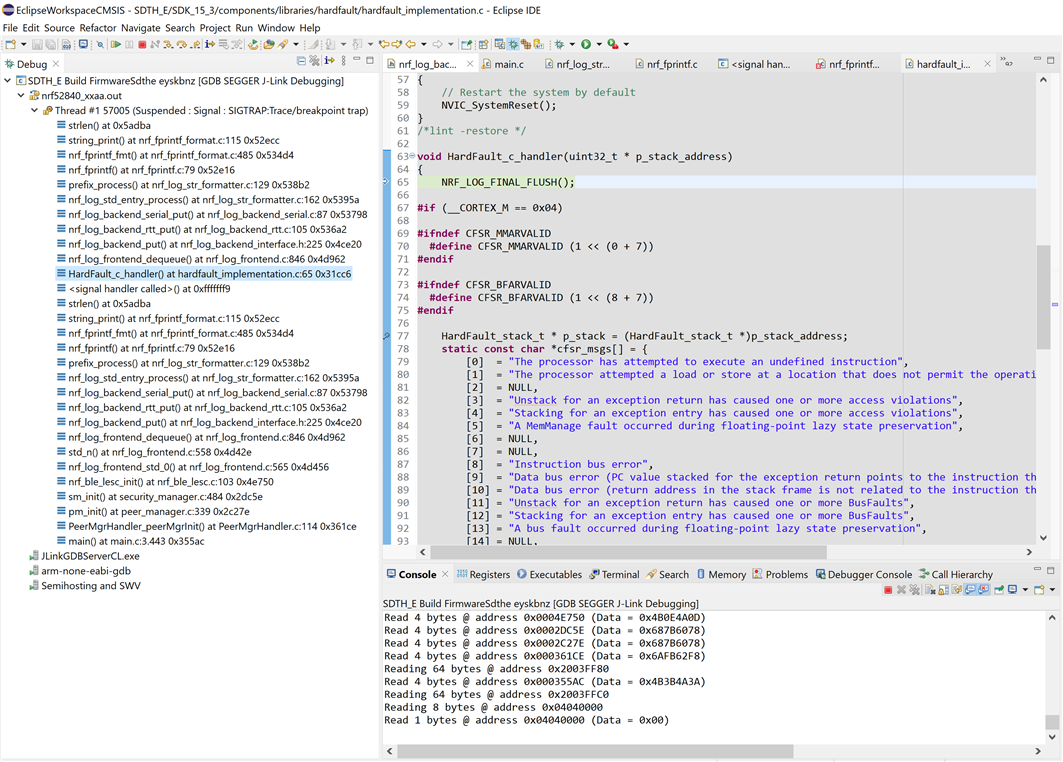

I have joined a screenshot from the debugging phase where the first NRF_LOG_PROCESS() check is done, at the left side of the screenshot
you can see how the µC runs to the HardFault Handler.

  • Hi!
    You should check the hardfault info to see why it hardfaulted.
    See this post on how to enable the hardfault handler library:
     RE: Catch HardFault
  • Hi Sigurd,
    following the description I have enabled the hardfault handler library, but I don't see any difference when running the CPU. Where can I get the needed information?

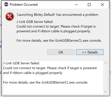

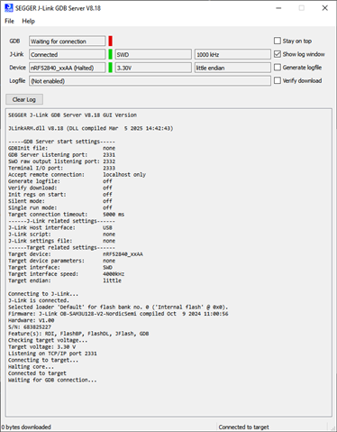

    it seems that there are some connection problems with the PCA10056 and my Laptop. When I start the Programmer (v4.6.0)  from nRF Connect for Desktop and select my nRF52840 DK with the series number 001050281280 I see some configuration action with partly red highlighted messages; the log-file contains this:

    What can I do now?
    BR, matthK

  • I have some more information: When compiling the Blinky example and trying to download to this PCA10056 in Eclipse an error message is displayed:
    In the console window this is displayed:
    SEGGER J-Link GDB Server V8.18 Command Line Version
    JLinkARM.dll V8.18 (DLL compiled Mar 5 2025 14:42:43)
    Command line: -if swd -device nRF52840_xxAA -endian little -speed 2000 -port 2331 -swoport 2332 -telnetport 2333 -vd -ir -localhostonly 1 -singlerun -strict -timeout 0 -nogui
    -----GDB Server start settings-----
    GDBInit file: none
    GDB Server Listening port: 2331
    SWO raw output listening port: 2332
    Terminal I/O port: 2333
    Accept remote connection: localhost only
    Generate logfile: off
    Verify download: on
    Init regs on start: on
    Silent mode: off
    Single run mode: on
    Target connection timeout: 0 ms
    ------J-Link related settings------
    J-Link Host interface: USB
    J-Link script: none
    J-Link settings file: none
    ------Target related settings------
    Target device: nRF52840_xxAA
    Target device parameters: none
    Target interface: SWD
    Target interface speed: 2000kHz
    Target endian: little
    Connecting to J-Link...
    J-Link is connected.
    Firmware: J-Link OB-nRF5340-NordicSemi compiled Feb 11 2025 17:15:35
    Hardware: V1.00
    S/N: 1050281280
    Feature(s): RDI, FlashBP, FlashDL, JFlash, GDB
    Checking target voltage...
    Target voltage: 3.30 V
    Listening on TCP/IP port 2331
    Connecting to target...
    ERROR: Could not connect to target.
    Target connection failed. GDBServer will be closed...Restoring target state and closing J-Link connection...
    Shutting down...
    As the target voltage is measured correctly I have the impression, that the debugger chip has no valid communication with the nRF52840. Is there a special configuration / jumpers at the PCA10056 to consider?
    BR matthK

  • Hi Sigurd,
    I have just looked for another PCA10056, and with this and your settings finally this works. I can compile, download and run the application - thanks for your support!
    The only thing which doesn't work correctly is when setting a breakpoint in a line and let run then the stop is not in the selected line but 4 or 5 lines later - do you have any idea how to solve that?
    Now I will continue migrating my firmware application from our target electronics to the PCA10056; finally what we want is to be able to search a special bug with trace functionality...
    For this I will keep SDK15.3 to create a minimum of new bugs while migration to PCA10056.
    If you have any special recommendations please feel free to send them to me.
    BR, matthK
