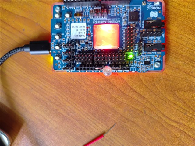

    I am trying to make GPIO P0.07 to high, in my nrf5340 Audio DK. Externally I am connecting an LED between P0.07 and GND. But it not showing any voltage between them. below is my code

But the board's inbuilt red led is glowing.

  • Oh sorry, I referred to the red LED in the blank plastic window in the middle. I didn't actually measure the voltage on the pin header, where you have connected the external LED.
    But have you tried measuring the pin with a multimeter/voltmeter? And what voltage does your LED require? And are you sure you put the LED in the right orientation? Have you tried connecting it the other way?
