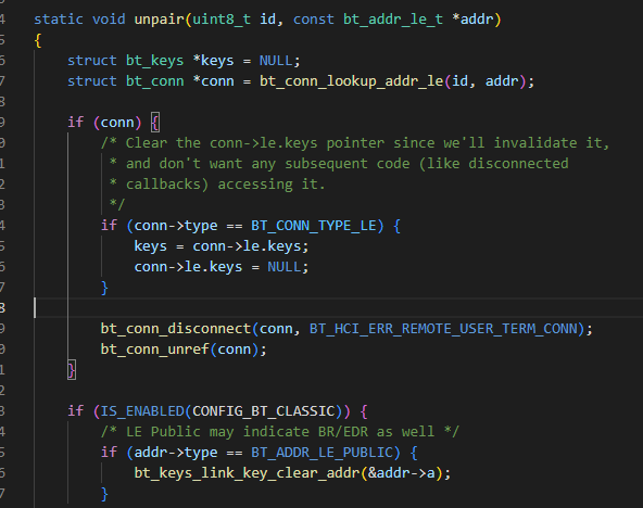

Hi Michalek,
It's expected to have the ongoing connection (that get unpaired) to disconnect.
I am not sure it's described in the documentation. But from the code I can see that ongoing connection will be terminated:
hci_core.c
