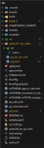

  • I successfully built both cores using the sysbuild.cmake file found in the ipc_service example. Additionally, I managed to build Bluetooth on the network core without any issues.
    However, when I tried to apply the same approach to my existing project, I encountered problems because my project does not include a sysbuild.cmake file. If I remember correctly, my project was originally based on the peripheral_uart example, which I have since modified extensively.
    I attempted to build the project similarly to ipc_service. I created a src/main.c file inside the sysbuild/ipc_radio folder and modified the prj.conf file within the same folder. However, I encountered a build error, even when I commented out the entire main function. The error occurs during the configuration file processing stage:
    C:/nrf5340/zephyr/include/zephyr/bluetooth/gatt.h:919:34: error: 'CONFIG_BT_MAX_PAIRED' undeclared here (not in a function); did you mean 'CONFIG_BT_RX_PRIO'?
    919 | #define BT_GATT_CCC_MAX (CONFIG_BT_MAX_PAIRED + CONFIG_BT_MAX_CONN)
    C:/nrf5340/zephyr/include/zephyr/bluetooth/gatt.h:937:36: note: in expansion of macro 'BT_GATT_CCC_MAX'
    937 | struct bt_gatt_ccc_cfg cfg[BT_GATT_CCC_MAX];
    This error occurs when I enable CONFIG_BT_NUS=y in the configuration file.
    The key difference between my approach and the ipc_service example is that in ipc_service, I added the src folder inside the remote directory and modified its prj.conf file. In contrast, in my current project, I modified the prj.conf file inside the sysbuild directory.
    MJ Park
    The peripheral_uart cannot run on the netcore. It would use the ipc_radio sample for the netcore by default; see the peripheral_uart/Kconfig.sysbuild.
