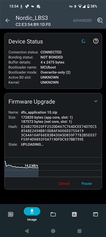

But now I want to add BLE DFU )
As I understood from examples, I should use app core for smp server, so I should use ble communication support on app core, which changes my whole architecture.
Could please anyone help me with that situation? :)
    What you want to do is not the standard way to do stuff, so it is not supported or tested.
    However, it can be done.
    First, tell me: Do you want to update both cores?
    How large is your network core application?

    Im not a BLE expert, but I can suggest that if you want to verify this, check our DFU SMP service ( and .c file), as this is the closest we got to that.
    But yes, this implementing of your own service for SMP.
    valeriy_simakov said:
    I think I can write BLE service wrapper of smp service to get data and send it to app core (data, len).
    Nice!
    On app core I can write smp_uart wrapper to receive data. What do you think about it?
    I would suggest that you use DFU Target on the application core to receive the data. This is the library we have for custom handling of received DFU binaries.
  • Hi
    Well, I'm stuck on the "wrapper of smp service" on the app core side. I couldn't find an example of DFU Target usage in my sdk.
    Now I'm trying to use the "common way". I'm worried about BLE speed, because now I use BLE stack on the app core. But as I understand physically, net core will send the final data, am I right?
  • I mean, does the app core use the ble api via rpmsg in net core ? Аnd all the ble stack is contained in the network core.
  • Bad news. I can't get the same speed of data transfer.
