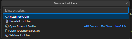

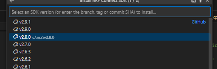

    The version in use is 2.8, and the executed main.c file has been uploaded.
    Thanks. I see the same on my end. According to the documentation, RSA OAEP should be supported with CryptoCell as well, and I am checking internally to understand more about this.
  • I initially suspected that my custom board had an issue, but even when I ran the RSA example with a 2.8V supply on the nRF5340 DK board, setting the board target to cpuapp, the same issue occurred. Even when building with _ns, key import works, but encryption does not proceed.
    My ultimate goal is to use the CC312 accelerator for RSA-2048 OAEP encryption and AES-CTR. I also suspect that cpuapp and cpuapp_ns are related to RSA encryption behavior.
    I have already spent two days on this issue and would appreciate a quick resolution.
    I origninally reproduced this issue by adding your code to the RSA sample, and that failes as you described. However, the reason is that the public key used in the sample is of the wrong size. with an updated 2048 bit public key (public_key_der) in nrf/samples/crypto/rsa/src/key.h, encyrption is successfull.
