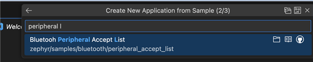

Not sure where to report this bug but I noticed that when typing sample names in "Create New Application From Sample", some Nordic samples do not show up...
For example, when you type "peripheral l" to find the "Bluetooth: Peripheral LBS" sample, the sample does not show up in the list. See screenshot:
It turns out that the sample in VSCode is actually called "Bluetooth LE LED Button Service".
Same problem with the "Bluetooth: Peripheral UART" sample which in VSCode is called "Bluetooth LE UART service".
Parents Reply
  • I know it does. The point of my post was that the names in the documentation are different than the names in the sample.yaml files, aka the README title. Bad UX.
