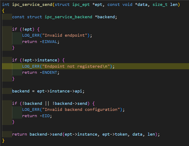

Upon checking the logs of both the application core and the network core, I can confirm that ep_bound is successful on both cores. However, when calling ipc_service_send, an error occurs:

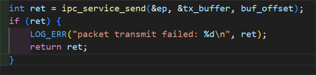

ipc_service: Endpoint not registered, and the packet data is not sent.
The packet size has been limited to not exceed 200 bytes for BLE communication, and even when reducing the packet payload to a minimal 20 bytes, the data is still not transmitted.

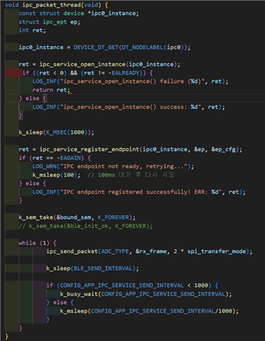

  •   <application core code>

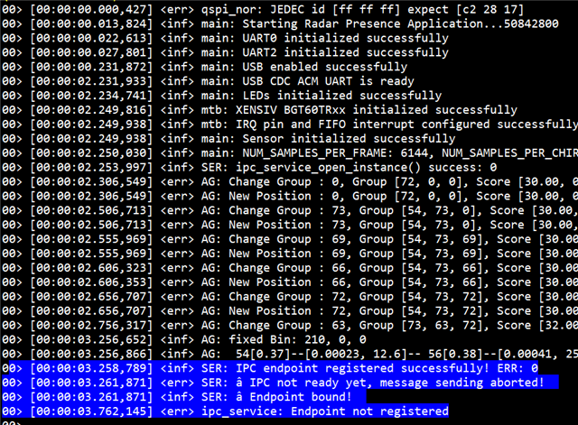

      <application core Log>
    This is the IPC-related function in the application, and I am sending it from a thread.
    In the logs, the message ipc not ready yet occurs because ipc_send_packet is designed to return until the ipc_ready flag becomes true. The ipc_ready flag is set to true once ep_bound is executed.
    As highlighted in the logs, the endpoint is successfully bound, and then ipc_service_send is executed. However, at this point, the error in the last line of the log occurs

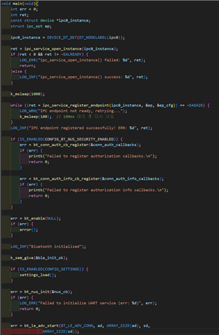

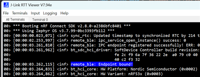

  •   <network core code>
      <network core Log>
    This is the main function code and log from the network core. The endpoint is also bound here.

    The function sends the packet once ipc_ready becomes true. According to the logs, ret=2 at this point
