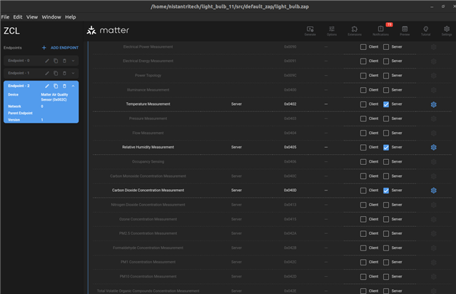

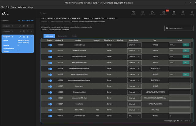

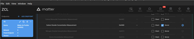

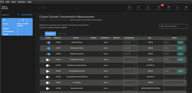

Unable Set Measured value for CarbonDioxideConcentration cluster
We are trying to add CarbonDioxideConcentration cluster in matter. we are able to add temperature and humidity clusters and values which are updated are getting read in chip tool properly.
From the post (https://devzone.nordicsemi.com/f/nordic-q-a/111148/matter-setting-carbondioxideconcentrationmeasurement-value) got to know that to set value for CarboDiaxide it needs to follow the sample example https://github.com/nrfconnect/sdk-connectedhomeip/blob/ca3672fbb939180da8e43e6994e01c89fa9dcd02/examples/air-quality-sensor-app/air-quality-sensor-common/src/air-quality-sensor-manager.cpp#L20
we implemented similar way but when try to read values in chip tool for CarbonDioxideConcentration it still fails.
Command have Used  : chip-tool carbondioxideconcentrationmeasurement read measured-value 1110111100001110 2
Error : ( [TOO] Run command failure: IM Error 0x00000501: General error: 0x01 (FAILURE) )
Any Hints or support will be appreciated to get it working
Have attached the code to add Temperature, Humidity and CarbonDioxideConcentration clusters in Light Bulb sample. The changes which are done for getting CarbonDioxideConcentration
values are as below

using zap tool i add cluster

    We have not gotten any closer with trying to fix the cause of the error, but I have a few ideas on what you can check on your end:
    1. What are you setting MeasuredValue to? Is is within the limits? (MinMeasuredValue, MaxMeasuredValue)
    2. Are you able to read the cluster revision? I see that the cluster revision has its storage option set to RAM and the other attributes are set to External. This may have an impact on reading the attribute values.

  • What are you setting MeasuredValue to?
    By using Rand() function Measured Value setting between 0 to 5000.
    MinMeasuredValue &  MaxMeasuredValue Not able to set
    Storage type of Min & Max MeasuredValue is External. If storage type change to RAM after that set min and max measured value but it shows by default Storage type External
    When the storage option is External, the cluster implementation needs to implement a class for accessing the attributes. The storage type is specified in the class functions. Are you able to (as a trial) set the MeasuredValue attribute to RAM and then read and write to it? If so, we can find out what is missing to make the External storage option work for the cluster.
