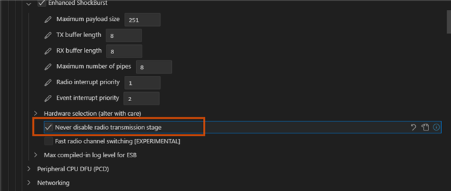

    When I changed the parameter on PTX and PRX "Never turn off radio transmission stage" to YES, communication stopped.

    Regarding the Kconfig never disable TX:
    config ESB_NEVER_DISABLE_TX
        select EXPERIMENTAL
        bool "Never disable radio transmission stage"
        help
          This option changes the radio behavior so that the
          transmitter remains IDLE between transmissions instead of being disabled.
          This is applicable only when the packet is not acknowledged. Otherwise,
          the radio emitter needs to be turned off to enable the radio receiver.
          This reduces delay between consecutive transmissions but consumes more energy.
    From what written here it should be able to reduce the time between TX packets. Please try testing on the SDK's sample.

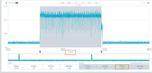

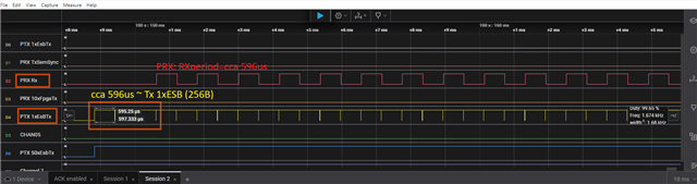

  • Thanks for your answer,
    Activating ESB_NEVER_DISABLE_TX is excluded from the activated ESB_FAST_SWITCHING.
    When I activated ESB_NEVER_DISABLE_TX  to YES ESB handler was not handled. Only FAST_SWITCHING is good solution, but he have data rate only 3.34Mbps (50 x 256B / 29ms).
    I want to know why data rate is not 4Mbps and why activating ESB_NEVER_DISABLE_TX stops the handler service.
    Here is oscillogpraph for one ESB packet and 50x ESB packets

  • Hi Peter,
    I think you are hitting the limit. You can't expect the actual payload data to be equal to theoretical bit rate. This is due to:
    - Overhead: address byte, preamble, CRC
    - Radio switching time. The radio has to switch between TX and RX. Even with FAST_SWITCHING the switching time is 40us.
    The longer the packet the less number of radio switching. However , longer packet may have higher chance of interference and get corrupted. If you enable re-transmission the whole bigger packet will have to be retransmitted. So you need to balance between high through put and waste on packet loss and retransmission.
