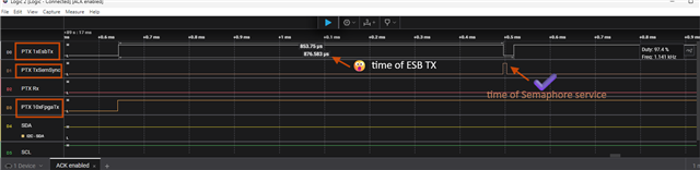

configured to 4Mbps ~ 2us/byte
ACK and never disable TX radio
I need transmit about 10kBytes of data so speed as possible. When we used K_SEM() in PTX for TX ready detecting it was works good, but real data rate (including overhead) was about 2.3Mbps.
I have found that one ESB transmission (256 bytes) expires about 850us, but the net transfer time (without ACK from PRX) is about 512us. How long is the ACK from PRX? Is this measured time acceptable?

Time measurement
