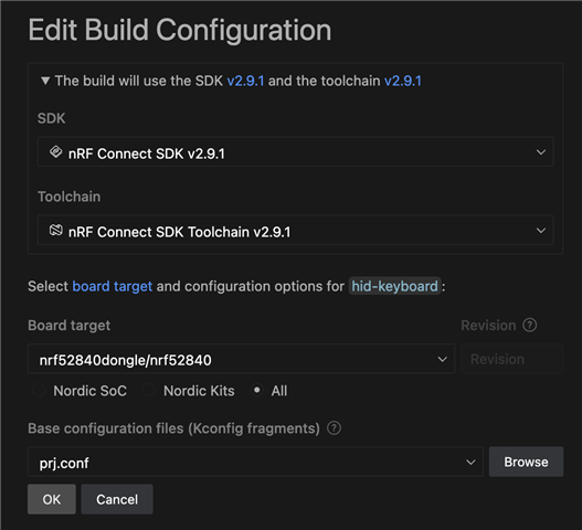

I got an nrf52840 dongle(PCA10059) and I'm trying to run the official usb-hid-keyboard example on it, but the compilation is failing. What could be the cause, and how should I go about modifying the example code?

the toolchain and sdk is v2.9.1, board target is nrf52840dongle.
