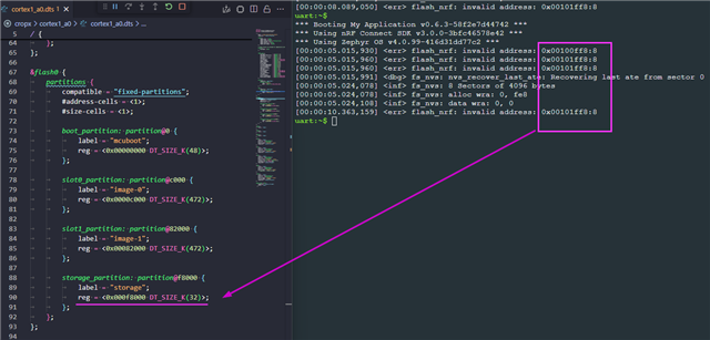

I have an nRF52840 based custom board (myboard, NCS2.70)
its partitions node closely follows the nRF52840DK dts file:
both have &flash0 in the /chosen group
zephyr,flash = &flash0;
However when creating an nRF52840DK build it runs fine, while 'myboard' build crashes when mounting.
I've single-stepped both configurations and noticed that 'struct fs' is not initialized to the same values - specifically 'flash_device' member has different value.
What am I missing?
Thanks
  • Hi!
    I suggest checking the compiled zephyr.dts , and see if there are any differences there that could explain it.
  • Hi thanks for your prompt response.
    What should I look for in zephyr.dts...? (attached)
    2063.zephyr.dts
  • Thanks!
    It seems pretty much identical to the one built for the DK.
    Do you have the compiled .config file as well?
  • Hey,
    Attached is build/zephyr/.config (I assume this is the one you meant).
    (had to rename it to config.txt due to some upload constraint)
    Thanks
    Do you have any more information about the crash, maybe from the log? What kind of crash is it?
    Also, could you try doing nrfjprog --recover, and then flash the sample again, and see if the issue persists?
  • ...been away for a while, surprisingly the problem was not solved ;)
    Anyway,
    I've migrated to 3.0.0, still the same problem.
    did recover (from within 'connected devices' pane in NRF connect VS code addon, same problem.
    However, there is ** MPU FAULT *** Data Access Violation message on the RTT terminal window (when single stepping nvs_mount() line)
    chatgpt and co. hint that it has something to do with the partitions...
    any advise will be greatly appreciated, as this is really frustrating..
    Thanks
