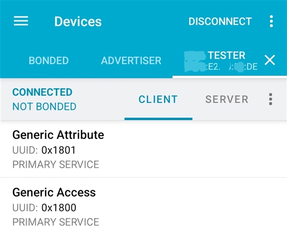

  • Thank you for your response.
    The attached screenshot from nRF Connect for Mobile shows only the default services, with no additional ones added. Despite multiple attempts to disconnect and reconnect, the issue remains unchanged. I have also tried using nRF Connect for Desktop but observed the same behavior.
    Regarding your question about why I am trying to add dynamic service like this way, I want to add services dynamically based on specific conditions in my app
    Have you noticed anything in the code I provided that might be incorrect and potentially causing the issue?
    Please click on Generic Attribute.
    Have you added CONFIG_BT_GATT_DYNAMIC_DB=y ?
    I don't see a problem with your code. But could you take a look at this test sample :
    \zephyr\tests\bsim\bluetooth\host\gatt\sc_indicate
    It does exactly what you want to do (see peripheral.c).
