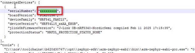

    I've masked some of its content (since this post is public). The masked content is as follows:
    The data of serialNumber:
    Some environment variable paths under environment:
    Some environment variable paths under inherited:
