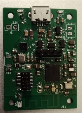

I designed a custom NRF52832 board and need to connect it to an ESP32 board. I soldered five boards for testing and also have an NRF devkit.
However, the ESP32 only detects two of the boards, while the others are not recognized. When I scan using the nRF Connect app, it detects all of them. Additionally, I suspect there may be issues even with the working boards, as some data packets are missing intermittently. This could be due to antenna mismatch or possibly unexpected board resets, but I'm not sure. The NRF devkit works properly without issues.
I'm using the internal LF crystal with the following configuration, which I added to the beacon example code:
CONFIG_CLOCK_CONTROL_NRF_K32SRC_500PPM=y
Attached are the schematic and Arduino code for scanning BLE MAC addresses. I made slight modifications to the Arduino IDE BLE scan code to scan for a specific device. what would be the reason for this issue?
