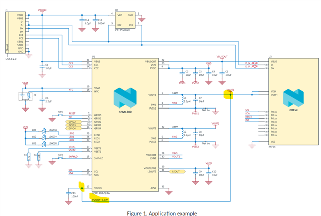

I was wondering if there was a way to implement a physical on/off switch to the npm1300 that would allow the outputs to be isolated form the battery but still having the ability to charge the battery.
I have attempted adding a switch between VSYS and PVDD as highlighted in the following image, but when the switch is in the off position, disconnecting VSYS from PVDD, the battery starts draining around 1 to 2mA. This is a higher drain from the battery than what it's using on the on position.
Do you have any recommendations on where to add a switch to function as an on/off? I would prefer to use a switch than a pushbutton for my use case.
