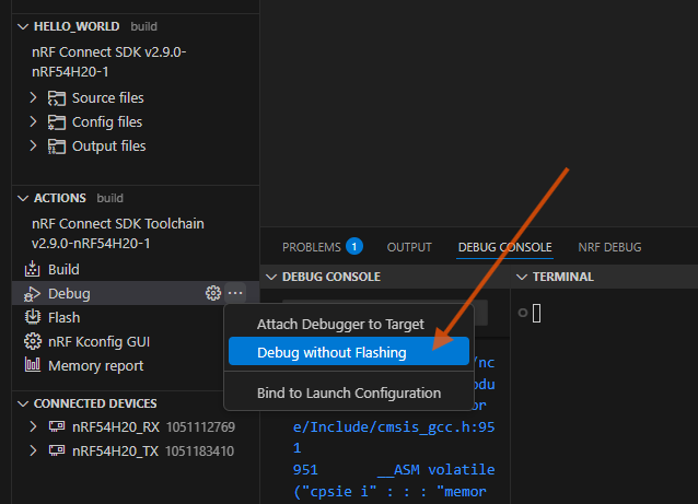

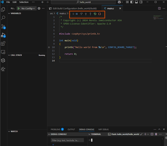

    I need to debug IPC application. I tried to do it on "hello world".
    Project was successfully built with next west command:
        west build --sysbuild -p -b nrf54h20dk/nrf54h20/cpuapp -T sample.sysbuild.hello_world.nrf54h20dk_cpuapp_cpuppr . -- -DCMAKE_BUILD_TYPE=Debug
    After flashing via west I was connect debugger from VSC to APP core at TX 54H20DK board:
    The debugger seems to be running, but it's not working as I intended. Neither pausing nor restarting worked.
    How can I debug a dual-core application on the nRF54H20?
