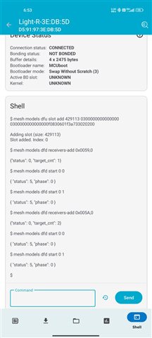

I'm using Distributer and target sample code for testing OTA in ble mesh. Using nrf Device Manager App I'm able to upload dfu_application.zip file to distributer and after this same dfu_application.zip file should be transfer to target devices. I have used shell commands to transfer file, but getting error as show in screenshot attached below.
pls provide proper shell commands or is there any error in these steps.
