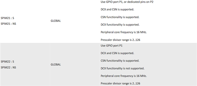

Hi, the datasheet v0.9 has been updated regarding the CSN. According to Configuration table on p. 564, all SPIM instances support CSN, is that correct? I am asking, because the data sheet still states "Chip select (CSN) hardware control is supported in some instances of SPIM".
Also, the table is contradictoy:

Hi Florian,
Thanks for doing the hardwork :) The datasheet is still on version 0.x so there is still a lot of thing to improve and clean up :)
Regarding the the table, what you meant is the duplication of
DCX and CSN is supported.
CSN functionality is supported.
DCX functionality is supported.
correct ?
Hi Hung,
what I meant is:
SPIM22
DCX functionality is not supported.
I see, thanks. It's now reported.
