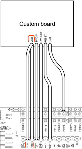

Unable to flash nrf9160 - is my design correct?
I have designed this schematic according to reference designs provided by Nordic Semi, however I might have failed as I am unable to flash the main module. I should mention I am a beginner, however not a complete beginner, as I've created functioning PCBs in the past.
I am flashing it using the nrf9161DK via SPI and I am sure the connections are correct. Still, the Programmer app of Nordic SDK doesnt recognize the new board with the nrf9160
Below is the schematic:
Thank you for your help

  • Hi, Matej.
    When using the nRF9161 DK to program an external board, you should use the SWD connection, as described in the nRF9161 DK's documentation.
    If you want to perform DFU on your board using a connection different from SWD, you should check out the Bootloaders and DFU lesson in DevAcademy.
    Mathias
  • Yes, sorry I used the wrong term. Of course I used the SWD connectors, in my design headers SWDCLK1 and SWDIO1. What I'd like to know if there is a flaw in this schematic that would explain why it does not work
  • Ok, understood.
    Are you sure you've made the connections exactly as in the documentation? Are you using a custom connection or a standard 10-pin connector?
    What error do you get when attempting to flash?
  • Sorry for not being able to reply sooner and thank you for your time so far.
    I'm using a custom connection (single header pins) connected to the respective header pins on the NRF9161DK's P20 cluster. In my design, I'm connecting them to the same names as on the DK, with the only difference of VTG => 3V3
    The following is the log file of "nrfjprog --eraseall --log" with the DK connected by USB to the host computer and my board connected to the DK by the P20 pins

  • Nothing to worry about, Matej.
    But VDD and VTG on the DK are still connected to the same net, right?
  • To be honest I don't fully understand your question - are you asking about how the Nordic product is wired? I'd guess the answer to your question is yes - and both should provide nice power supply to the board being programmed. However I'm already using VTG and my board that's being programmed seems unresponsive.
  • I'm sorry if I was unclear, Matej. I was just referring to VDD and VTG on the DK being connected to the same VDD net on your custom board, as shown in the documentation.
    Do you get the same error when using nrfutil?

  • I can confirm my connection is the exact same as on the picture you attached.

  • Thank you, Matej.
    You are able to flash the DK itself when the custom board isn't connected to it?
    Have you tried powering the custom board externally, rather than from the DK?
