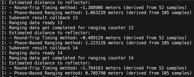

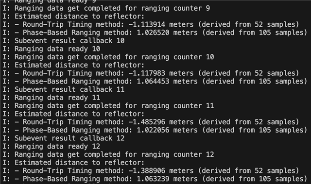

I am currently working with two nRF54L15 DK boards placed approximately 50 cm apart and stationary. I am using the channel_sounding_ras_ example with SDK v2.9.1 to evaluate channel sounding precision.
However, I am encountering significant variations in the measurements, even though the boards remain static. Additionally, I am unable to achieve a precision better than half a meter.
To improve accuracy, I have adjusted several parameters, including:
abstracts from main.c (initiator)
line 437 and 438
		.rtt_type = BT_CONN_LE_CS_RTT_TYPE_128_BIT_RANDOM,
		.cs_sync_phy = BT_CONN_LE_CS_SYNC_2M_PHY,
line 476 and 477
		.snr_control_initiator = BT_LE_CS_INITIATOR_SNR_CONTROL_30dB,
		.snr_control_reflector = BT_LE_CS_REFLECTOR_SNR_CONTROL_30dB,
Despite these modifications, the precision remains poor, and I occasionally observe large fluctuations in the results.
Could you provide guidance on how to improve the accuracy and stability of the channel sounding measurements? Are there additional parameters I should adjust, or known limitations with this setup?

  • Hi
    I'm sorry, but the Channel sounding is still very much in experimental mode yet, and the ranging algorithms are very basic, so very accurate ranging can't be expected at this point. We will have better versions coming, but in the end the algorithm for ranging is up to you to improve as it will be outside of what we support in the SDK.
    Simon
