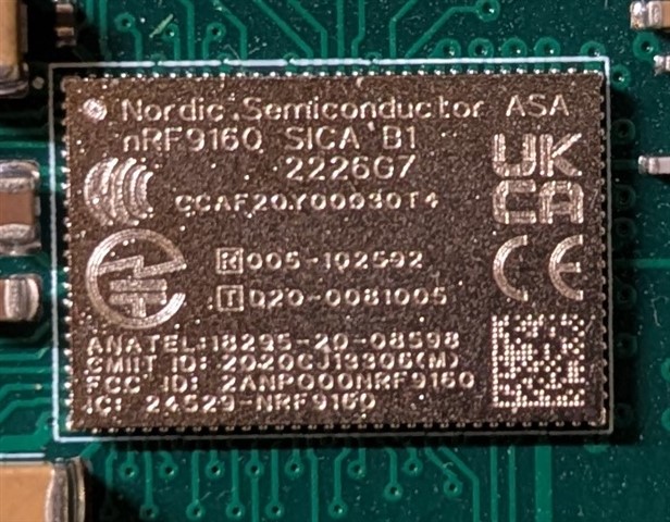

nRF9160 wont register but sees an available network
Recently I've had an issue with 3 of our nRF9160 based products during production (several hundred of the same hardware/firmware/SIMs work fine). The issue is that while the modem has good signal and can see the network we wish to connect to (+COPS even reports <stat>=1 / available), +CEREG reports searching endlessly (<stat>=2). There doesn't appear to be any errors being reported, it's just not registering. I've tested numerous variations: different SIMs (and providers), our firmware and AT client, different locations to obtain a very strong signal, left it operating for many hours at a time...
I've run a modem trace (full) overnight (100MB). I've browsed through it but don't see anything obvious to explain my problem. The following are of note...
* There is a RESET LOOP event reported every 3 hours which coincides with our application rebooting (does do a CFUN 0). I assume this is just reporting the reset loop counter being stepped and not that it's reached the point of restriction. Regardless, 3 hours should be long enough to clear it. I see no evidence of modem reboots.
* There is a pattern where +CEREG includes <tac>,<ci> and <AcT> for a short period following an attach request then it returns about 13 minutes later. e.g.

I'd appreciate any thoughts as to what might cause this behaviour and what additional analysis I can do.
Configuration: nRF9160 SICA B1, SDK 2.3.0, mfw 1.3.3 and 1.3.5

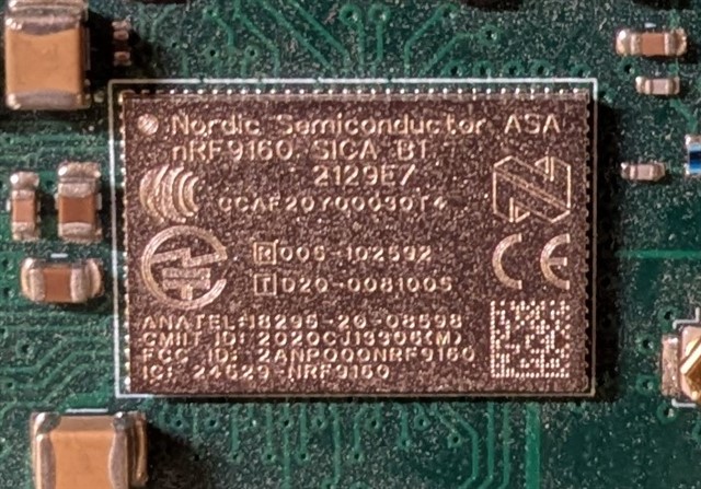

  • I've captured a new modem trace over 20 min from the time the modem is turned on. It demonstrates the same cyclic behaviour as mentioned previously. It looks like several connection requests are being made before waiting 12 minutes and trying again.

  • Hi Charlie,
    I've run a new trace on two devices (700 works and 855 fails). I only have hardware to capture trace from one unit at a time so I ran the same test (same SIM) consecutively. The devices are sitting side by side. Both devices are the same hardware, firmware and mfw. 700 is a little older (still B1A). I've also attached photos of the nRF module on each.
    700 trace (ok).mtrace855 trace (fail).mtrace
