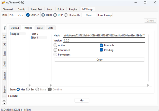

Hello, I am test DFU USB function with my Thingy53. So far, I have been able to add DFU USB support from my application but not from the MCUboot. I am using the recommended AuTerm (v0.35a) to upload and read images. I can successfully upload the "signed_by_mcuboot_and_b0_ipc_radio.bin" file with the Test option, and this could be confirmed by reading images again as shown in the figure.   But from the terminal output, I can see an error and two inf log outputs as shown:
[00:07:32.896,820] <inf> mcuboot_util: Image index: 0, Swap type: test
[00:07:32.897,888] <inf> mcuboot_util: Image index: 1, Swap type: none
[00:07:32.897,918] <err> mcumgr_img_grp: Failed to open flash area ID 1: -2
I found a similar issue about this error code here (https://devzone.nordicsemi.com/f/nordic-q-a/108054/flash-area-error-while-doing-dfu-using-nrf-connect), and my conclusion from this post is that this error should not affect the DFU process.
But after I issue a reset command, what I should expect is that the two images swapped. But what happens is: 1) This time I only have one image in slot 0, there is no slot 1 anymore. 2) the log information in the terminal change to:
[00:00:16.194,580] <inf> mcuboot_util: Image index: 0, Swap type: none
[00:00:16.195,220] <inf> mcuboot_util: Image index: 1, Swap type: none
[00:00:16.195,251] <err> mcumgr_img_grp: Failed to open flash area ID 1: -2
, which suggests both images are not swapable I assume? By checking the hash number of the image in slot 0 after reset, I can confirm it is the same image in slot 0 before I issue a reset command. So what happened is, after I issued a reset, the image in slot 1 just disappered while image in slot 0 is active. I attached my prj.conf file here:
