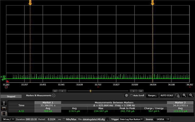

nrf54L15 sleep current was 3uA using NCS\v2.8.0\zephyr\samples\boards\nordic\system_off
I test my nrf54l15 module(disconnect every gpio with outside),the sleep current was 3uA,seens can't not achieve 0.6uA as the datasheet said.
The nrf54L15's markcode is QFAABB 2435AD.
I testing with the default setting of NCS\v2.8.0\zephyr\samples\boards\nordic\system_off sample.
