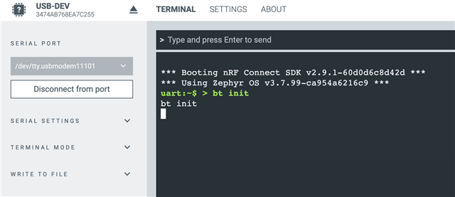

I have a problem with unmodified BLE Shell and changing security level to 2(aka just works).
1. I'm connecting from BLE Shell to the device that requires level 2
2. After the connection is succesfully established I'm trying to perform `bt security 2`
3. It fails and outputs some strange communicates
Why it mentions `level 1` when I tried to change it to `2`?
The device works great with Android and iOS phones. It also worked some time ago with previous versions of BLE Shell, but it doesn't work on latest ones.
uart:~$ > bt connect D6:32:F3:DB:E1:DA random
Connection pending
Connected: D6:32:F3:DB:E1:DA (random)
LE data len updated: TX (len: 27 time: 328) RX (len: 69 time: 664)
Remote LMP version 5.1 (0x0a) subversion 0x0101 manufacturer 0x0059
LE Features: 0x0000000000004125
LE PHY updated: TX PHY LE 2M, RX PHY LE 2M
LE data len updated: TX (len: 27 time: 328) RX (len: 27 time: 664)
uart:~$ > bt security 2
bt security 2
Security failed: D6:32:F3:DB:E1:DA (random) level 1 reason: Authentication requirements (4)
Pairing failed with D6:32:F3:DB:E1:DA (random) reason: Authentication requirements (4)
